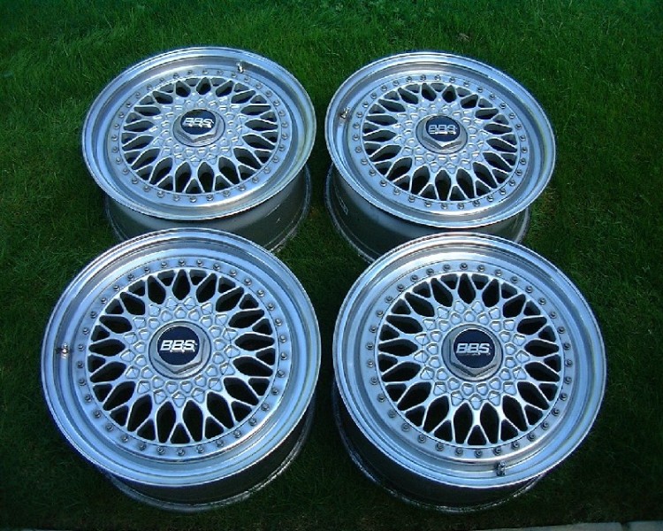

Split Rim Refurbishment
BBS RC042
BBS Split
Rim, BBS RC 042 - Used on the BMW E36 328i Sport and Australian E36 M3 GT

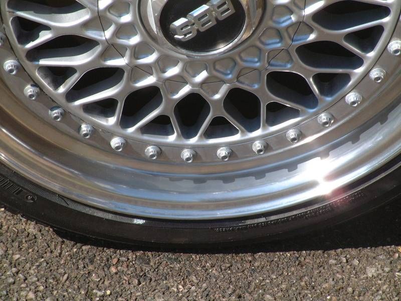

1) Undo the bolts on the outer rim and remove complete bolt assembly. Then
use a rubber mallet to knock through the centre section - this can require
a lot of force.
2) Use paint
stripper on the outer rims to
remove the paint/lacquer.
3) Purchase wet and dry sand paper grades 400, 800, 1200 and 1500.
Start with the most abrasive (400) and work your way up to 1500 if you are
happy to polish occasionally, otherwise stop at 800 and lacquer for a more
durable finish. If you would like an extreme polished look it is worth
purchasing some G3 (rubbing compound) from a body shop and using a metal
polish afterwards on the outer rim. The benefit is if you ever curb your
wheels (so help you God), the metal is already bare and they can just be
sanded down and re-polished.
4) The
centres often remain in good condition, but if they are not it is worth
sending them off to a local sand blaster and powder coater to have the
centres and caps re-done. If you would like to give it a go, follow the
same procedures as above to wet and dry grade 800, then apply a few coats
of BBS silver spray paint (or alternative) and finally a few coats of
lacquer.
5) Remember to use some liquid
thread lock when resealing the wheels or
alternatively you can pay someone else to do it all for you.
